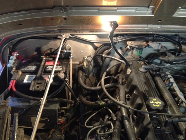

Re: Colorado JP #29
yes it is a superwinch lp8500.
Removing the control box (solenoid) wasn't too bad. (obviously disconnect battery/winch before starting)
First remove the 4 screws in the plastic box to get access to the inside of the box. The top half of the plastic box has the wires for the remote, so it comes off, but can only be moved out of the way unless you want to unwire the remote wires. You do not need to unwire the remote wires, it gives you enough access that you can get the rest of the stuff undone.
Second: with the top loose enough to access the internals you will have to unbolt the power bars. The winch has 3 SOLID Copper power bars that connect the solenoid to the winch motor. They are about 1/8 in thick solid BARS. Unbolt these three bars.
Third: There is a small black ground cable that goes from the solenoid down to the winch's motor ground. This is held on by 1 screw on the solenoid and bolted along with the main ground cable to the bottom of the winch. Remove this cable.
Fourth: with all the wiring disconnected the box's lower half is connected to the winch with two brackets which are screwed to the box with 2 screws each and 1 screw each into the winch body. Remove the 2 screws into the winch body with a long screw driver.
The box should now be free to be removed from the winch. Then I removed the 2 mounting brackets from the box.
I choose to make new brackets that screwed into the existing holes in the bottom portion of the box, but you might could bend/adjust the brackets if you wanted. They aren't super thick.

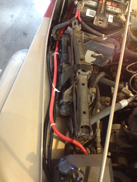

Re wiring: You will need 3 - 2 gauge wires to reconnect the box to the winch, and one 12ish gauge ground cable. I choose to also replace the positive main cable that came with the winch since the new location was so much closer to the battery, instead of having extra cable coiled in the engine compartment. So I got 4 - 2 Gauge cables, All four cable based on MY LOCATION were 42" long. Measure VERY carefully if you have cables made you don't want to be short, BUT you also don't want to coiled a bunch of 2 gauge wire either!!!! Plus the shorter the cable runs the better electrically you are making the circuit.
From the solenoid to the winch are 1 "positive" red cable (this is actually I beleive called F1 and is "white") and 2 "other" cables (one "yellow" and one "green" (F2 and F3 technically I believe), I used black with colored electric tape at each end to differentiate, I doubt you could find battery cables in anything other than red and black, but I didn't look real hard). Connect the cables to the same terminals that the bars were connected to originally, making sure to connect the correct lug on the solenoid with the correct lug on the winch motor. (pretty easy once you see how they are laid out when you start taking it all apart, but make a diagram if you are concerned about getting them right) The "positive" one has to be correct, or you will short something out. If you swap the "green/yellow" cables then the remote will work in reverse. The small (12 gauge) ground from the solenoid that you removed earlier needs to be connected to a ground. I choose to run this to the battery ground terminal itself as that was cleaner than running a 5th cable to the winch ground point where it was originally connected. (it was originally connected to the winch ground lug, which is directly connected to the battery ground terminal via the original main negative run, so I just went straight to the terminal.) Though you could probably run this to any vehicle ground as well.

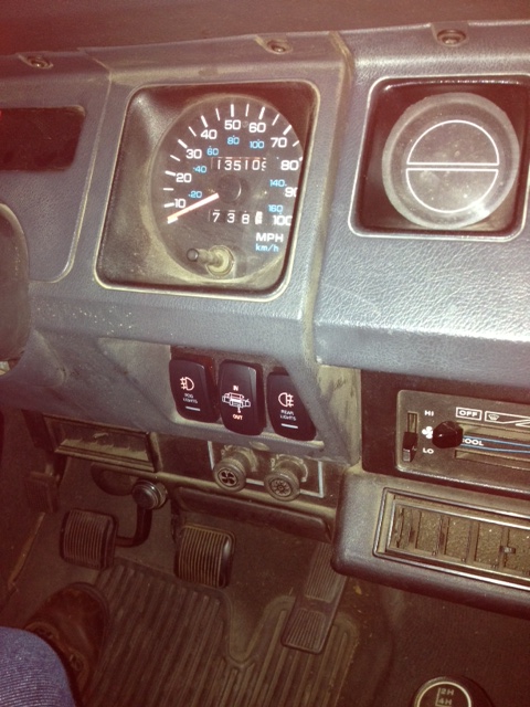

updates.. I went no expense spared with my electrical....
I am wiring up the rear fogs, redoing the wiring for my front fogs so they are independent of the headlight switch, and wiring up remote winch controls in the dash...
The stock fog light switch (and rear defrost switch if you had a hard top) are located in a panel at the lower right of the steering wheel. This panel has 3 cutouts already waiting for switches... So I took apart the dash to remove that panel, and opened up the 2 additional switch locations. I am installed Contura Laser Etched switches (no expense spared
So far I have completed the switch install, but need to wire them up. I will be stopping at radio shack today to get a 9 pin male and female plug to make future servicing easier.

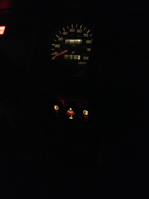

Ok spent the day getting all wiring to the proper locations, installing split loom in the engine bay, and getting everything organized, then plugging in my harness, and Bam all working!
Here are the switches all Installed.. ignore the dusty jeep, it needs a cleaning!!!! And here they are with the dash lights on. Sweet!!! And here are the rear fogs lit up! The switches are all Contura Marine laser etched Switches by Carling. I ordered them from a place called Over the River and Through the Woods or otrattw.com. You can get a TON of switches from them, and they will even do custom work.... I almost thought about seeing what it would cost to do the rear fogs as "Dino Lights" but decided not to. The switches also have an indicator light on them for when they are on. (I should have taken a pic with one switch on and one off.. ohh well. The Winch switch is a momentary switch, so you have to hold it. I choose amber as the led color, but you could choose a bunch of different ones.
I also wired in a winch cut off switch , so to use the winch you have to turn it on, before either the in dash switch or the remote will work. So no accidental winch usage.
No expense spared, all of the wiring is either bundled into existing wire looms or has new wire looms on it.

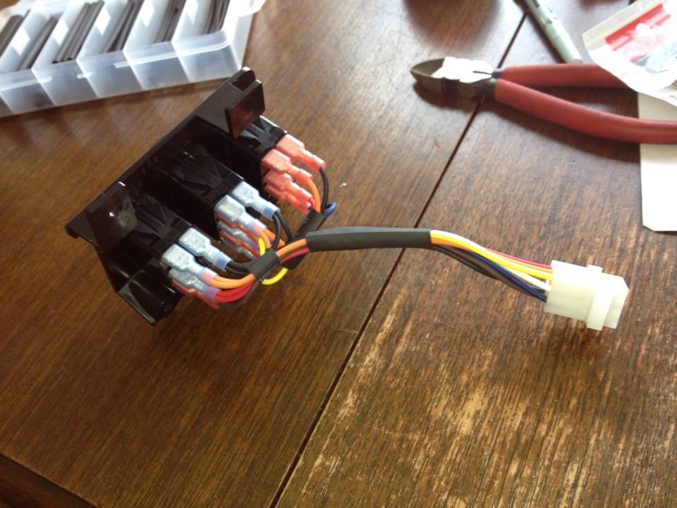

My final harness had 7 leads required
Ignition power - I tapped into the radio switched feed as it was handy back there
Dash Light power - The back of the headlight switch has a wire that feeds the dash relay, I tapped into this. The manual says it is blue with red strip, but mine was black with a yellow strip. The manual did show the connector and what was where in the connector, and the wire was in the correct place in the connector.
Front Fog control wire (low voltage) - feeds relay
Rear Fog control wire (low voltage) - feeds relay
Winch In control wire (low voltage) - feeds winch solenoid
Winch Out control wire (low voltage) - feeds winch solenoid
Ground

Ok... Here are the harness pics
First the harness behind the switches... Its all low voltage so all 18 GXL auto wire, 7 inputs wires, but lots of connections across the 3 switches, a 9 pin plug, which i got at radio shack. Next the new loom in the engine bay. The wires exit the firewall through the rubber plug the stock engine harness goes through. Then follows the massiv wire loom along the top back of the engine bay going from right to left in the picture, till it gets over the battery. Above the battery is the new relay for the rear lights (just below the radiator support bar). The wires then follow the left edge of the engine bay (pic 2) and proceed up to the solenoid box (which I had already remote mounted last year) PS the new loom is the small one that looks ultra black
