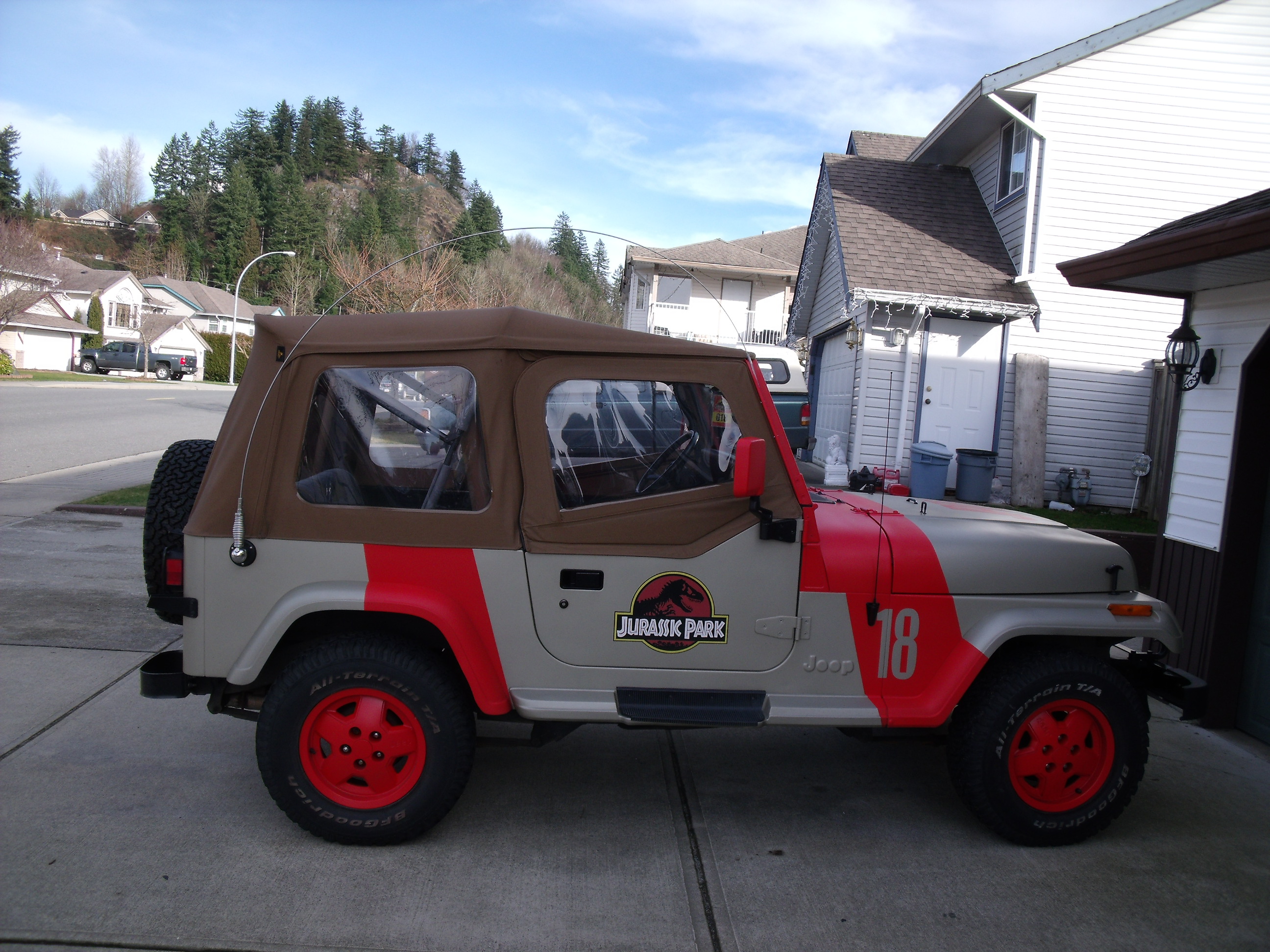

I hope mine looks that good when I make the change from black. What brand top is that?

it is bestop replaceatop in spice.
some of you shape eyed viewers may have noticed that i dont have the normal soft top.
the one i have is designed for use with the full doors not the half doors. then i got the windows for the half doors to fit it

What are the color codes for your paint? I LOVE IT!!!!!

ok so paint codes
sand beige poly 92 jeep color: 27055
performance red 92 ford color: 4614 (remember unlike the beige this need flattener added to it)

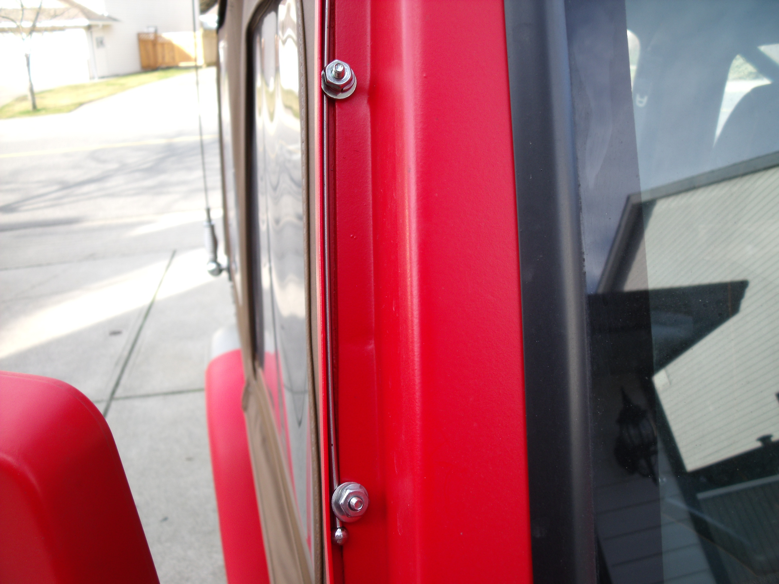

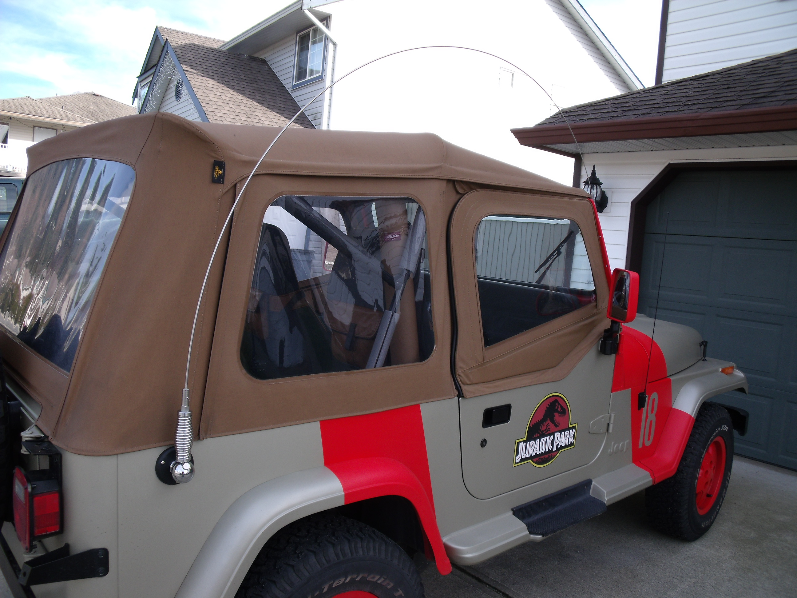

here are some pictures i took today after i got the antenna installed and I was having a tough time figuring out how to attach that bad boy to the windshield and they were not any good pictures of how other guys did besides using a light bar which i dont have yet so i used some small bolts, washers and nuts

Totally, that would bring it one step closer to the film. The paint is spot on, great job with that! What were the specs on the original if you don't mind me asking?

I have that top also. I am still using the full doors until I paint my half doors...
Great colors there....thanks for the codes, I will be ordering my Red pretty soon...
